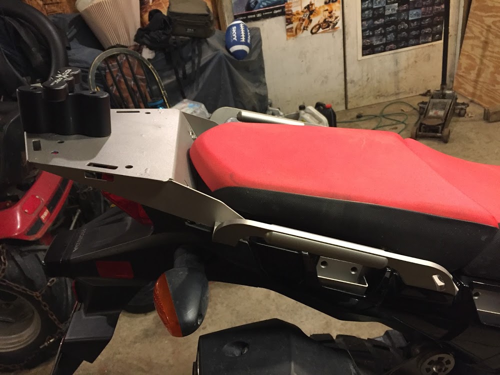

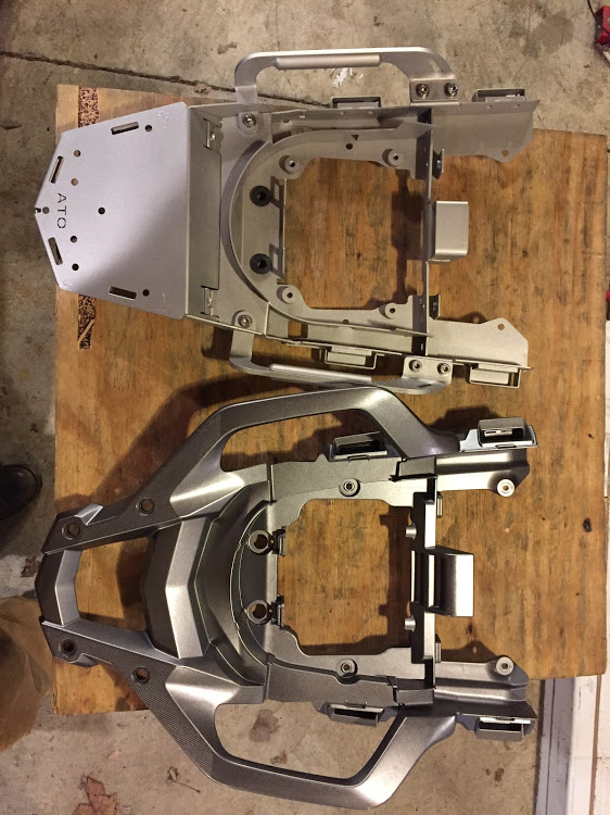

Jenkkilän pojat viritelly uutta rosterista takaosaa uuteen afrikkalaiseen. Tuotos on nyt ennakkotilattavissa (395$). Kiinnostaa paljonkin, mutta toimituskulujen, ALVin ja tullien jälkeen hinta lienee jossain 650 €uron hieppeillä. Eihän tälle muuten olisi tarvista, mutta kun tuli hommattua Mosko Moto Reckless 80 -laukut, joka istuu paikalleen paremmin ilman AT:n isoja kauhukahvoja...
Täältä löytyy pari videota.spartanman @ Advrider.com kirjoitti:Thanks for your patience. The pre-production prototype is done and we’re ready to make production racks! Other than the production-style tubular grab handles, which were prohibitively expensive for a single pair, this prototype incorporates all features of the production rack:
+ Bolt-on replacement for OEM rack
+ Precision, all stainless-steel construction
+ Pockets to accommodate OEM and aftermarket pannier racks
+ Removable grab handles
+ Pre-drilled for OEM and aftermarket top case mounts
+ Pre-drilled for Roto Pax mount
+ Four 2-hole M8 threaded interfaces for attaching soft-pannier racks and other accessories
+ Four M8 threaded bushings for mounting accessories in the passenger seat location
+ Attachment hardware included
